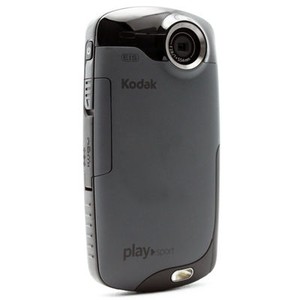

All en route:
Kodak PlaySport Zx3
Macro Lens
SD Card
Another Chrono
AEP Glock mags (x6)
Kodak PlaySport Zx3
Macro Lens
SD Card
Another Chrono
AEP Glock mags (x6)
