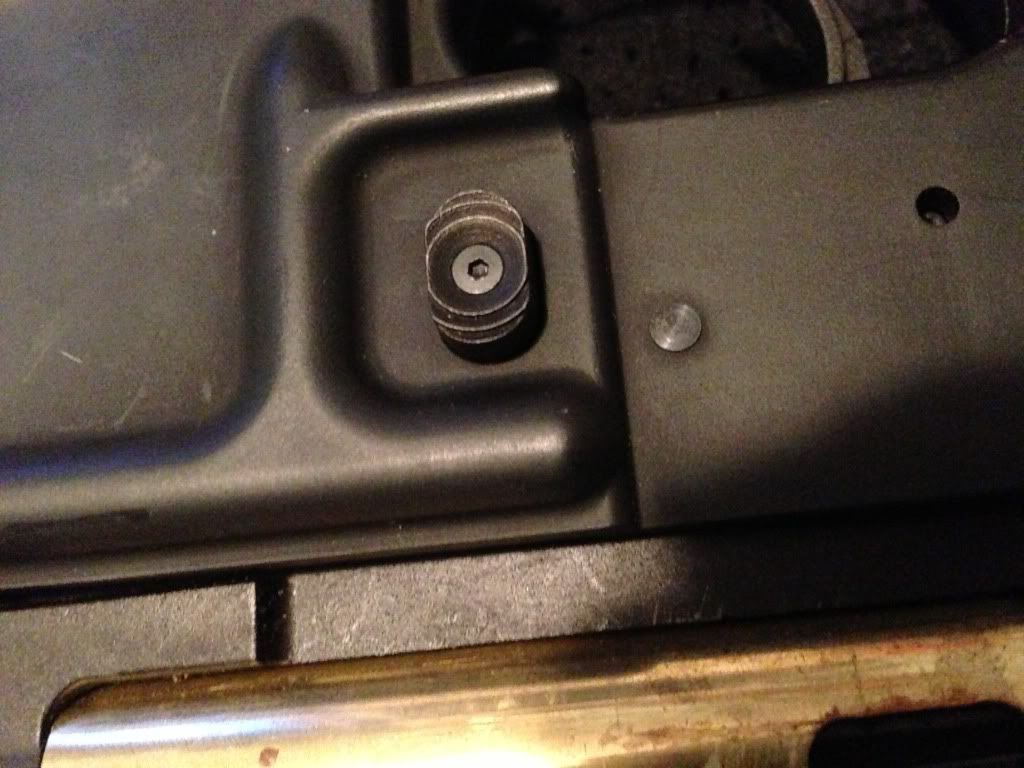

Last screw to get my gearbox out. And we don't have any torx that small...
Re: DMR Build Planning and Questions READ: STAR, DOM, SKYWAL
It's an imperial hex head, usually the smallest one that comes in the pack, iirc.
And I hope you've got a good collection of torx heads for the gearbox shell. It uses T9 I believe, a size up from the normal TM T8. It's rather annoying imo, it does nothing but require more parts to take apart gearboxes, and KWA is the only gearbox who uses those screws.
- Romba
An imperial hex head is different from an Allen key, right?
Same thing, Hex Head = Allen Key. They are both 6 sided tools, imperial means inches, feet, miles, vs metric, where everything is meters. You said Torx Screw drivers, and those are the star shaped ones.
- Romba
Ohh. I thought it was a torx. I guess not.
