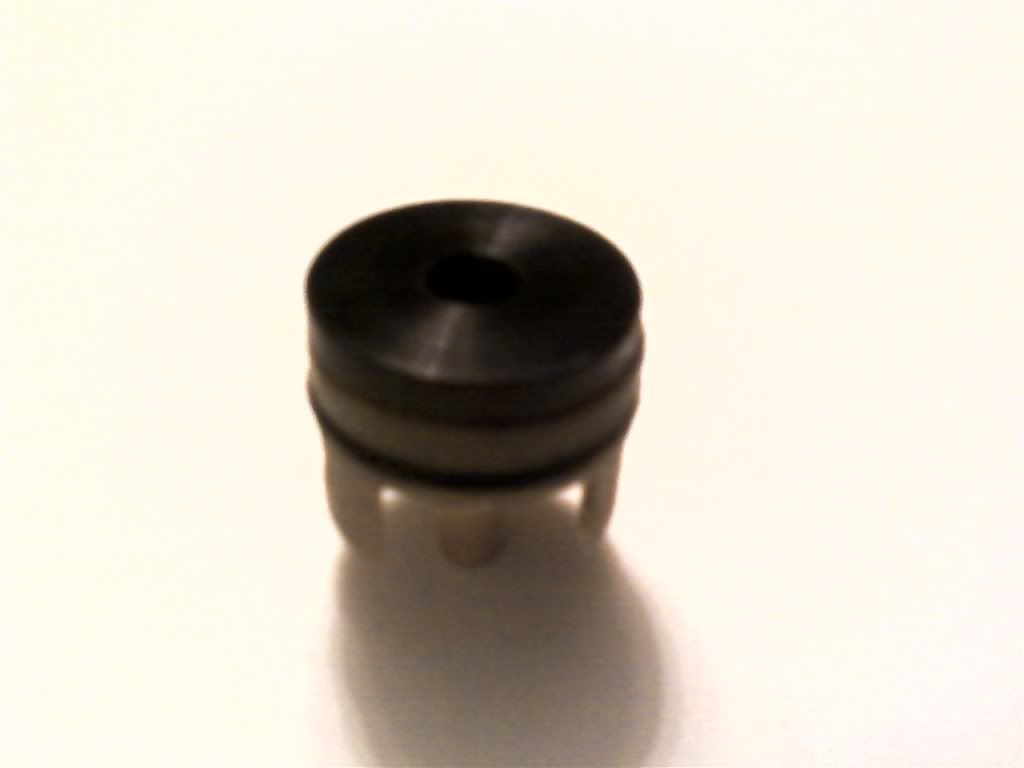

- Sorbo Pad:
1. What is your specific Sorbo Pad arrangement?
One piece Sorbo, stacked Sorbo, and are there any Spacers on the Piston?
Typically, a 1/8 Sorbo Pad stacked on the stock Sorbo Pad, or vice versa, does the job as far as setting AOE position.
Picture: 1/8 Sorbo Pad stacked on stock Sorbo Pad:

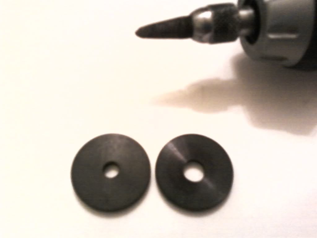

2. Did you bore out the center hole of the Sorbo Pad.
I tell people this all the time and it makes a huge difference both in performance and in function of the Sorbo Pad.
Standard - Left / Bored out - Right

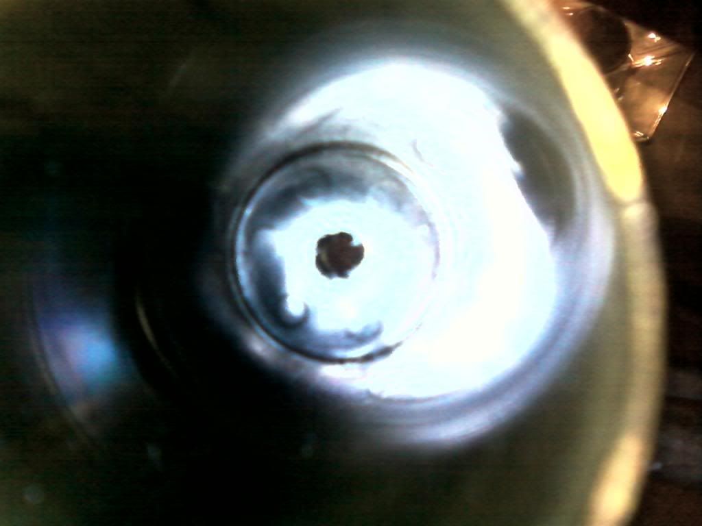

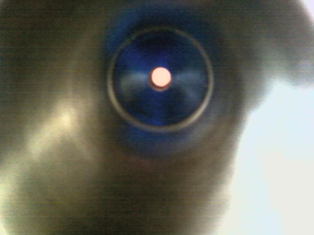

This is what can happen to the center hole when you do not bore it out.
This is because the Sorbo will settle in a bit as it breaks in, so it flattens out.
As the Sorbp Pad wears down and out, it can really flatten out.
The only place for material to go is inward at the center hole, especially if you both perma-sealed it in and used the correct size added Sorbo Pad, which should be larger than the stock Sorbo Pad and just a bit smaller than the Cylinder so you can actually fit it in.
Picture:

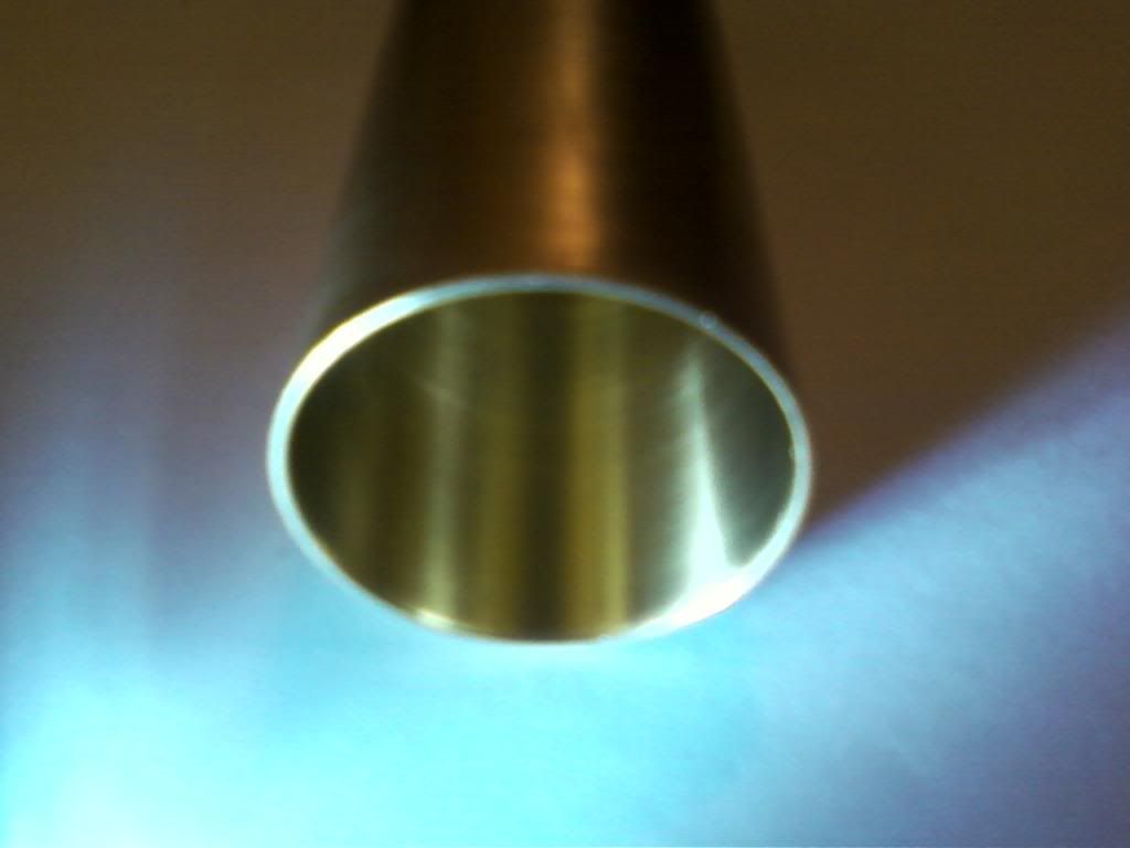

3. Is the Cylinder and Cylinder Nozzle clean and free of all sealant you may have used?.
I use Acetone to clean, then a Dremel with a steel wool polishing wheel.
This makes it super clean and gives a mirror finish.

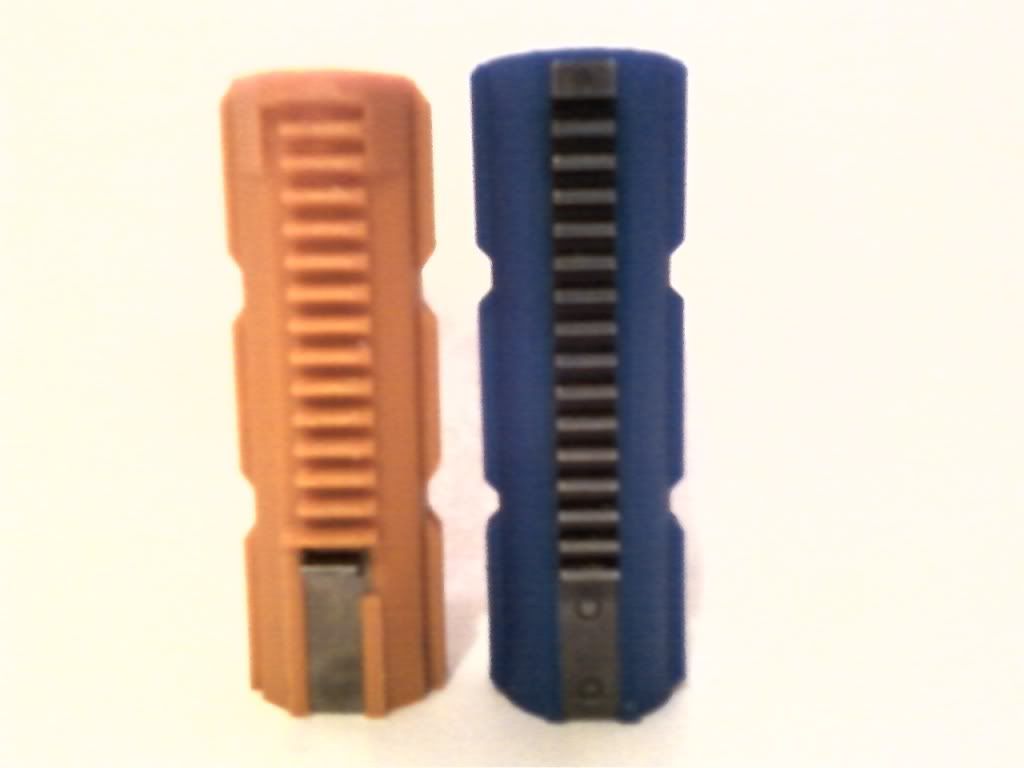

Piston:
The SHS 15 Tooth Piston Body is (or was at one time) a bit longer than a standard size Piston.
At least, I had one that was indeed like this a while back.
I do have a new SHS 15 Tooth Piston in my parts bin now, but it seems to be the same body length as a standard Piston.
Pay attention to this and make sure your Piston is lined up correctly and also not adversely affecting your AOE.
Original SHS 15 Tooth Piston I purchased over a year ago beside a stock JG Orange Piston.

Sorbo Pad -
I used the stock sorbo pad on the cylinder head, in addition to a 3/16" sorbo pad from Clandenstine, and one of the thin neoprene sorbo pad covers. It appears to be a substantial amount of sorbo, and looked to be the best amount to work with correcting AoE.
As for the size of the sorbo I added, it was actually smaller than the stock KWA pad, possibly around 1/8" smaller in diameter. In other words the pad doesn't touch the cylinder walls. I did bore out the center hole to match that of the KWA stock pad.
Piston -
I stood the SHS piston next to the stock piston. They are the same size from what the eye can see. I will say that the SHS piston feels slightly lighter than the stock one, though I doubt that has anything to do with my problems. The AoE is at about 12 o'clock.

-Does it matter that my Sorbo pad has a smaller outer diameter?

Sorbo Pad -
Piston -

Yes I have tested out all the easy to test compression thingies.
I've done the typical cylinder compression tests, air nozzle included, and gotten great results. The air nozzle very, very slowly lets some air out, but that's typical of non o-ringed nozzles. I can feel the difference in air pressure coming out the air nozzle when shooting the gearbox. Definitely more pop than the ms120 spring I previously had, but that power is not translating out the end of the barrel.
As for the seal between the air nozzle and hop up, I have done both the flash light test, and the paper over the feed ramp test. Both tests are showing 100% seal. I have been playing with the thought of not having the nozzle kiss the bucking lip at the right depth or angle, but wouldn't these two tests reveal if that is the case or not?
If the nozzle / bucking kiss is the problem, possibly due to a change in tolerances from the batch my sr12 came from, then I may try to go about sanding down the front of the tappet plate. I don't know if this seems like an issue, but when looking into the hop up through the feed ramp, the nozzle barely touches the bucking lips. At most it seems it inserts itself a 1/2 mm or less.
