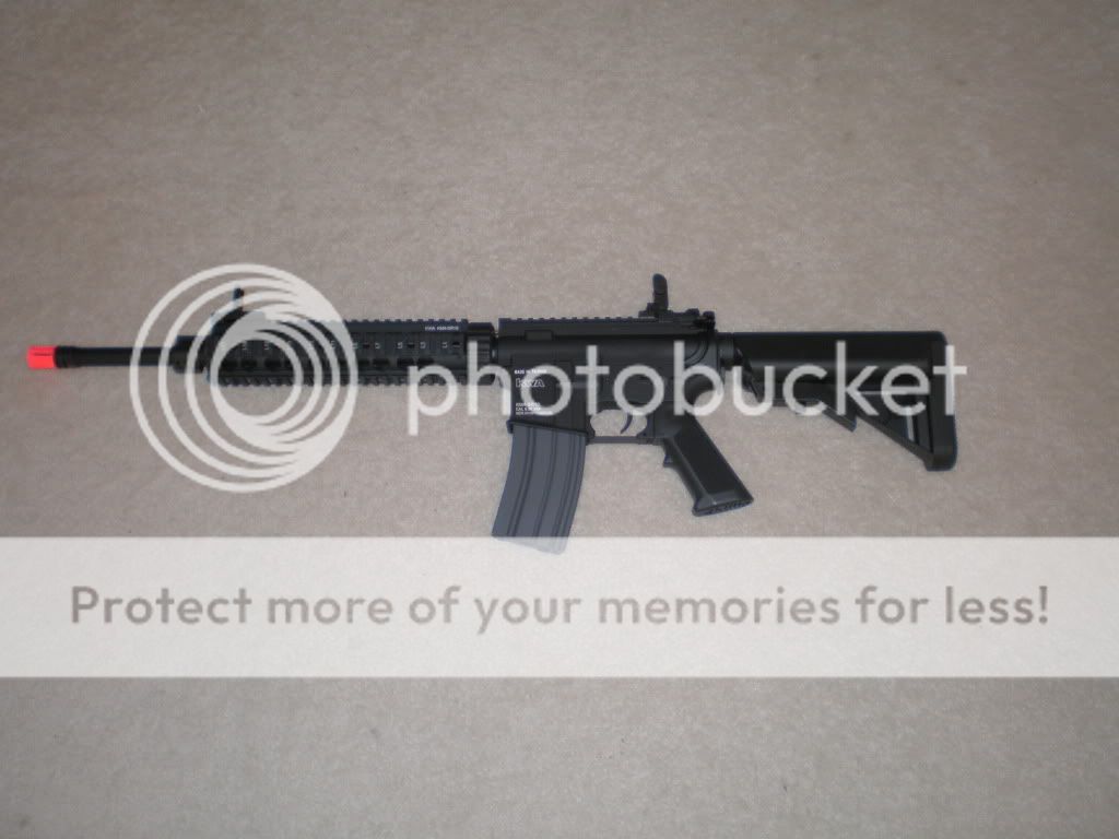

The newest addition to my collection.  A KWA SR 10. ;)

that gun is sick....and its a REALLY long m4 lol

Yeah, it's a bit longer than my G&G M4, but as of right now the hop up is screwed up.  No matter where the hop up is adjusted the bb's drop.  I can't make them curve up at all.  I'll get it sorted out though. ;)

sounds like a missing nubbin.  Nice addition.

Their hopups are really easy to take out and look at. Make sure you use KWA buckings. Any other bucking is usually too thick.

You're welcome, man. I've heard of a couple cases where the bucking shipped with the gun was ripped. If you inspect the hopup, and see it's not as it should be, give them a call and they'll send you a replacement for free if it was damaged on arrival.
You can remove the hopup and barrel pretty easily. Just fire in semi once or twice, unscrew the receiver pin near the fire selector and remove, and yank up on the upper receiver (I usually hold onto the stock and use my fingers to push up on the forward assist on the receiver to separate). The hopup should slide right on out  :)
I hope you can get it to work. You'll love it when it's shooting great.
